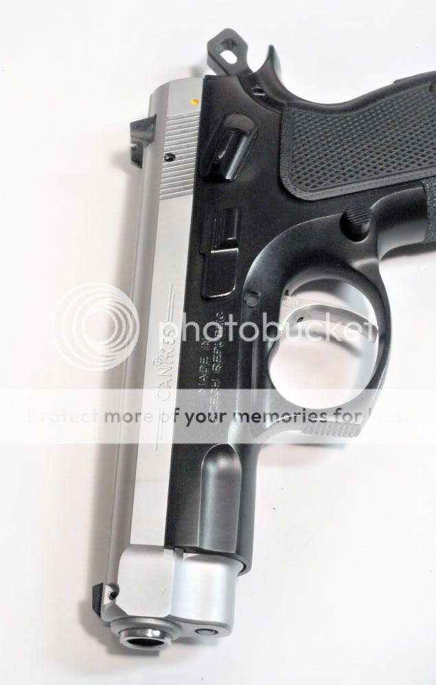

Well finally got the opportunity to see and handle a Canik gun. I talked with the Canik USA guy and made an appointment for him to come by the shop and see their gun. Dean Whitt arrived with one of their alloy compact guns for me to peek and handle. I was hoping too for a full size alloy gun, but he said they were out.
Quickly looking at the gun, it is pretty well made. fit is solid and tight. Double action was smooth and I am guessing in the 10#-12# range and the single action about 6#-8#. The single action feels pretty neutral with no camming. There is not as much creep as on a CZ, but seeing the hammer, the hooks are not as long on th Canik.

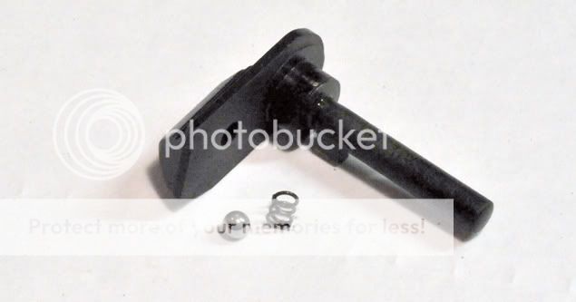

*SMALL PART WARNING* safety has a small ball bearing/spring that it uses to get a 'click' feel when moving. it will fall out when you seperate the safety from the side of the frame

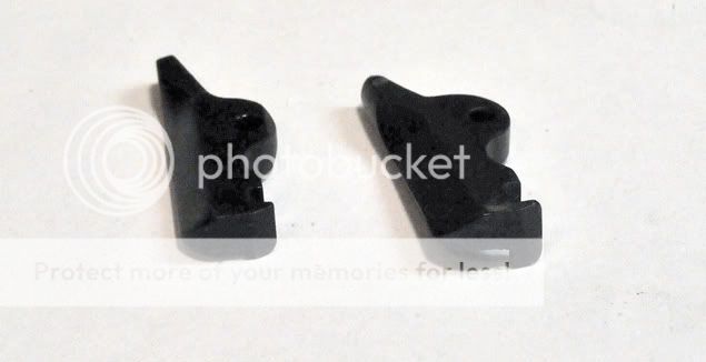

« Reply #8 on: June 16, 2011, 11:39:13 PM »
OK...here we go:

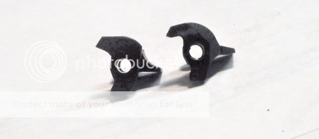

Canik sear on the left, CZ sear on the right

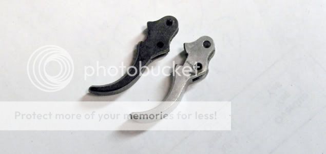

Canik trigger on left, looks like a casting and then coated. CZ 75B trigger is slightly thicker, but fits onto the trigger bar and in the frame.

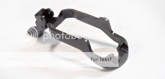

Canik trigger bar. seems to have less tool marks than CZ trigger bar.

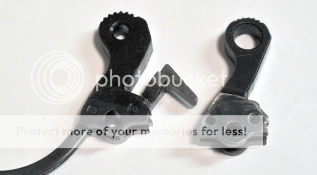

Canik hammer on the left. hammer pin hole is bigger on the Canik. CZ hammer could be modified to fit Canik frame and hammer pin

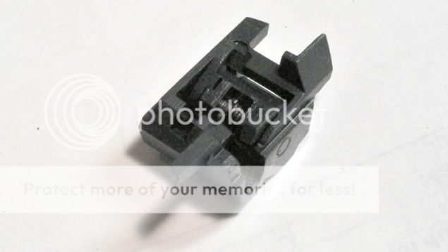

Ejector housing. sear and lifter are interlocked to each other. no lifter spring in the assembly

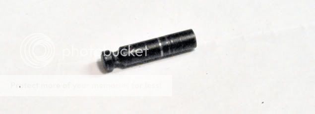

hammer pin. hammer pin retaining pin fits into the slot and keep pin from moving.
really small ball bearing and spring for safety.

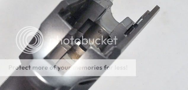

Canik slide stop in middle.

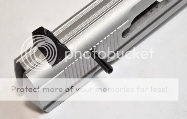

Only single roll pin to retain firing pin. CZ Custom solid pin does NOT fit.

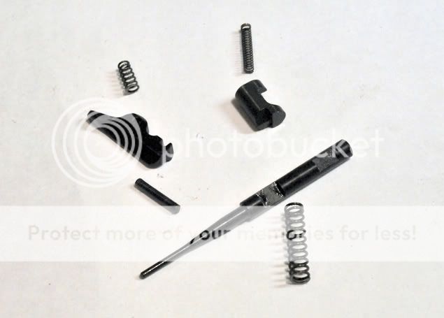

small parts of the slide

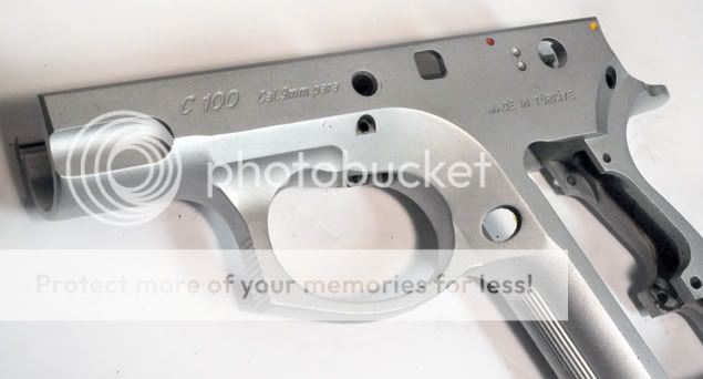

See the small hole in frame that trigger return springs fits into, CZ frame has a groove cut.
bare frame.

hahahha...I dropped that little ball bearing in the safety already. I wish they had a way of actually retaining it in the safety rather than just placed between the safety and the frame.
on a positive note while looking for it, I found a trigger set screw and a CZ fpb lifter spring. :D
