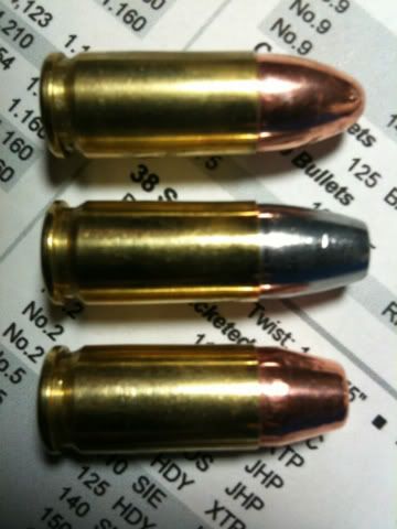

Here's my load for the Berry 124 gr HBFN:
6.4 gr Accurate No.7
Speer once and twice fired cases
Remington and Winchester primers
1.065 OAL (the bullet bottoms the rifling at 1.080")
.376 taper crimp
Top: 115 gr Berry RN
Mid: 147 gr SNS LFN
Btm:124 gr Berry HBFP
