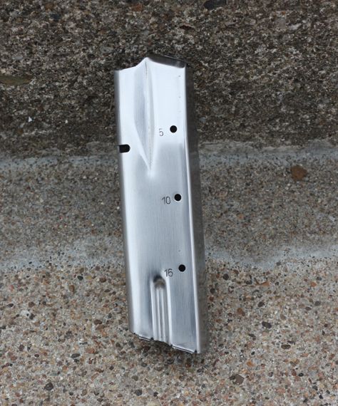

Over the weekend I finally got to a project I have been wanting to try for awhile now but just haven't had the time and that is hot bluing. I would like to some day be able to do high gloss hot bluing and that's what I was going for but my level of polish needs to be a lot higher as it turned out more of a semi gloss.
Here is the pic of the mag before anything was done. Note next to the number 5 there is a grey mark, I had some sulfuric acid on my hands and just happened to grab my mag and that's what happened about 1 year ago. Other than that there is just some normal wear and tear on the mag.
Now for the prep work, I did this all by hand with different levels of sand paper and no polish and that's where the glossiness comes from. I started with 180 and worked up to 3000grit paper but there are scratch marks that I didn't get out and by the end of all the hand sanding I didn't care. I think I need a sand blaster and some polish wheels for my bend grinder before I do this again.
Here a pic after the prep work.
