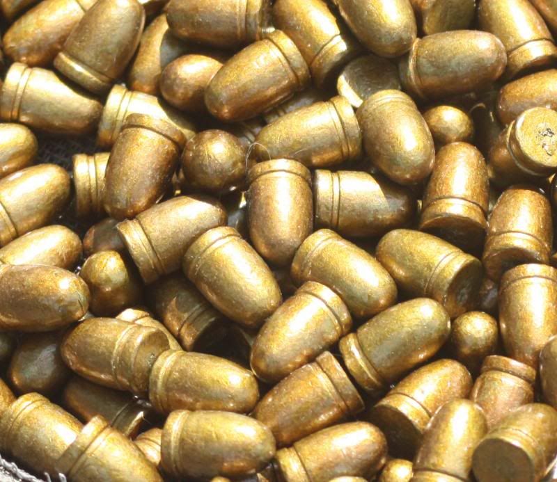

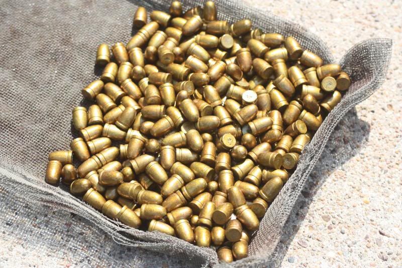

The other day I order some Hi-Tek coating from Bayou bullets after hearing great thing about it over at the Cast boolits forum. I got to say I wish I would have had this a long time ago this stuff is great not only do you not have to mess with a sticky lube anymore that bullets look good and you can push them crazy fast without leading.
The fastest I have pushed mine so far is 1350fps average out of a stock glock 17 and not a ounce of leading.Tho Hi-tek claims you can push them to 3200fps through a rifle with no gas check and still be fine as long as you alloy is the right hardness.
Also suppose to be a smokeless bullet now tho I never really notice smoke but for those who do this close help with that.
Here is my latest batch:
Cost was 86 bucks shipped I think tho the start up price is a little high and your stuck with one color it should coat 26k 115 9mm bullets so it should last a long time. I think if you compete this would be the way to go adds about .30cents per 100 to the bullets I cast.

It's pretty Easy the formula I used for the above bullets is 2ml color 2.5ml acetone and 40 units catalyst I mixed that in a glass jar and added 250ish rounds of the lee 125gr bullet and tumble lubed them for 30 secs and then put them on the rack to dry. Drying takes about 15 mintues and than another 15 mins in the oven for me and that's it. Rinse and repeat 3 times.
Now oven time is the important part and will vary from person to person they just need to be in only enough so if you run them with a acetone soaked rag you don't get any color to come off. Another test is to smash them with a hammer to make sure that coating doesn't chip but I think you only run into that from over baking.
This is my second rounds of 250 bullets I really messed the first ones up and they came up a brownish/green but they still worked just as good so the coating is pretty forgiving and if you can tumble lube alox you can do this.
