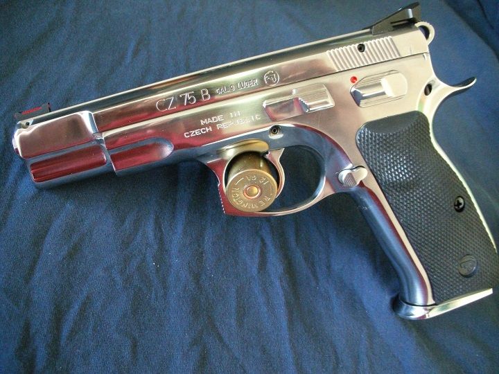

Offline Towns
  • Posts: 1749
Re: P01/P02 sights
« Reply #5 on: February 01, 2015, 07:42:14 PM »
Yes, with the factory hammer fully forward, it is difficult to manually cock it. That is the reason I changed hammers on mine.
With the competition hammer, it is much easier to cock with your thumb.
I did a google search and found this pic that looks like a 75 with EZ/D rear sight and factory hammer fully forward.
« Last Edit: February 01, 2015, 07:45:38 PM by Towns »

Offline mutant90
  • Posts: 6
Re: P01/P02 sights
« Reply #6 on: February 01, 2015, 09:16:02 PM »
Yes. With the new CZ Custom tactical rear, I can't pull back the factory hammer from the fully down position. Not a big deal, since I practice dry fire from the half-cock or fully-cocked positions.
Offline rossco63
  • Posts: 62
Re: P01/P02 sights
« Reply #7 on: February 02, 2015, 06:57:27 PM »
Yep. The OEM hammer can't be cocked from the full rest setting with the CGW sight. I'm solving that by installing a CGW hammer.
